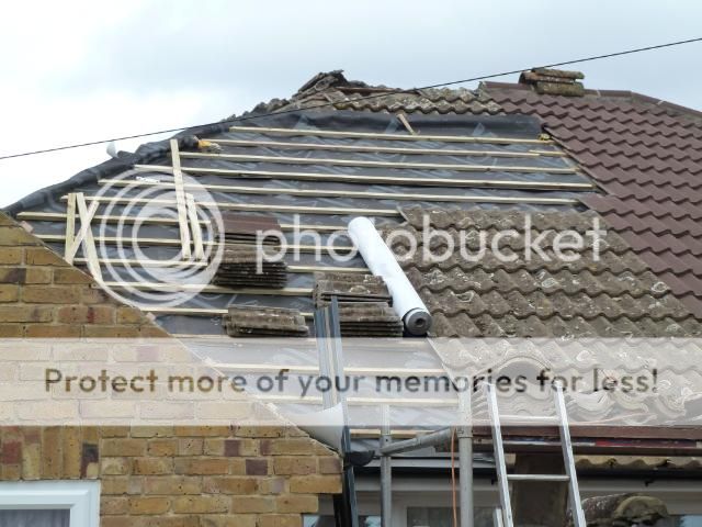

As well as the above, while I was insulating the loft, I investigated and discovered that the existing roofing felt had perished, and needed replacing. It wasn't even roofing felt that had been used, it was something that is called 'building paper', it's basically a type of paper with a very thin tar based middle, I mean wafer thin. It had deteriorated to the extent that it just crumbled to dust when it was touched.
I hadn't really allowed for repairing this in my budget, but it's one of those things that has to be done, as the saying goes, "you need a roof over your head" Very Happy
The only way to do this is to remove the tiles, and batten, and felt, and lay new felt, new battens, and re-use the old tiles. Ideally you would use new tiles, but the old ones were sound enough, and the budget isn't unlimited.
I was always going to replace the fascias and soffits, so done this at this time.

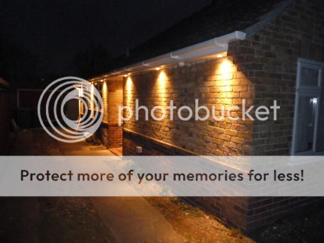

Whilst the old fascias were off, I took the opportunity to wire in downlights for the soffit, and over the front door, with a PIR detector. The finished article looks like this:

I like that very nice touch
PostSubject: Re: The Silk Purse Project   Thu Mar 01, 2012 8:02 am
Love what you have done with the decking & the lights around the house front mate. clap clap

Looking great Mark, absolutely love the down lighting outside (gonna pinch that idea for our new place)

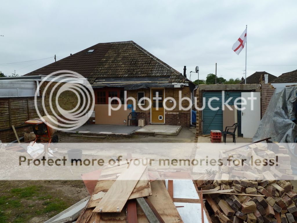

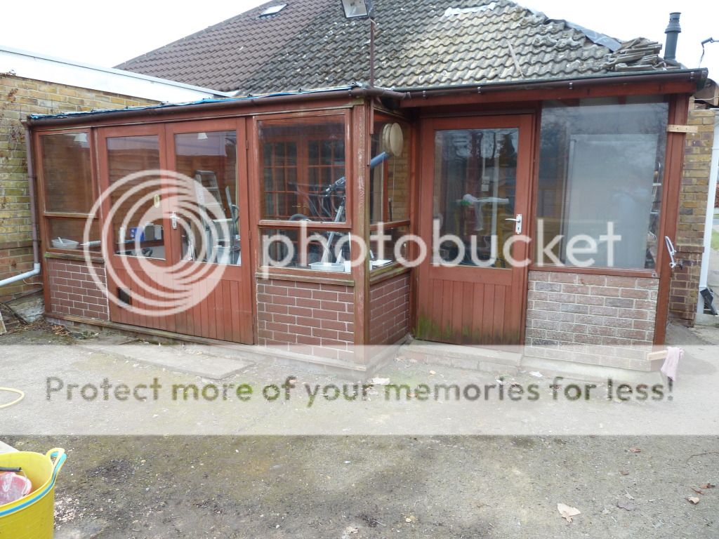

Today I also took the rear conservatory down.
So it did look like this:
And now looks like this:
Starting to amass a large heap of rubble now though wah

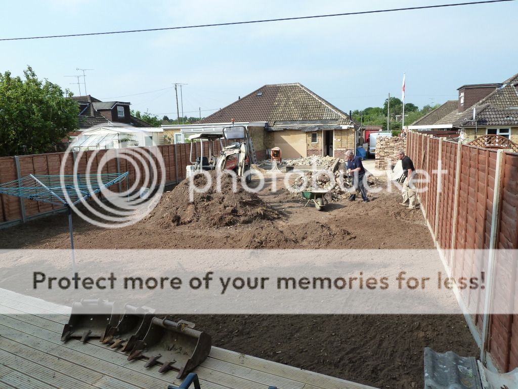

Ok so it's full steam ahead now. The garage had to come down to allow for the digger and dumper to get in.
Now once the garage is rebuilt, I won't have chance to get the digger in for the gardening work, so this has to come first, it also clears space so that you can move a bit more freely.
The rear had started to amass weeds and stuff since it was cleared at the end of last year, so this needed a scrape off

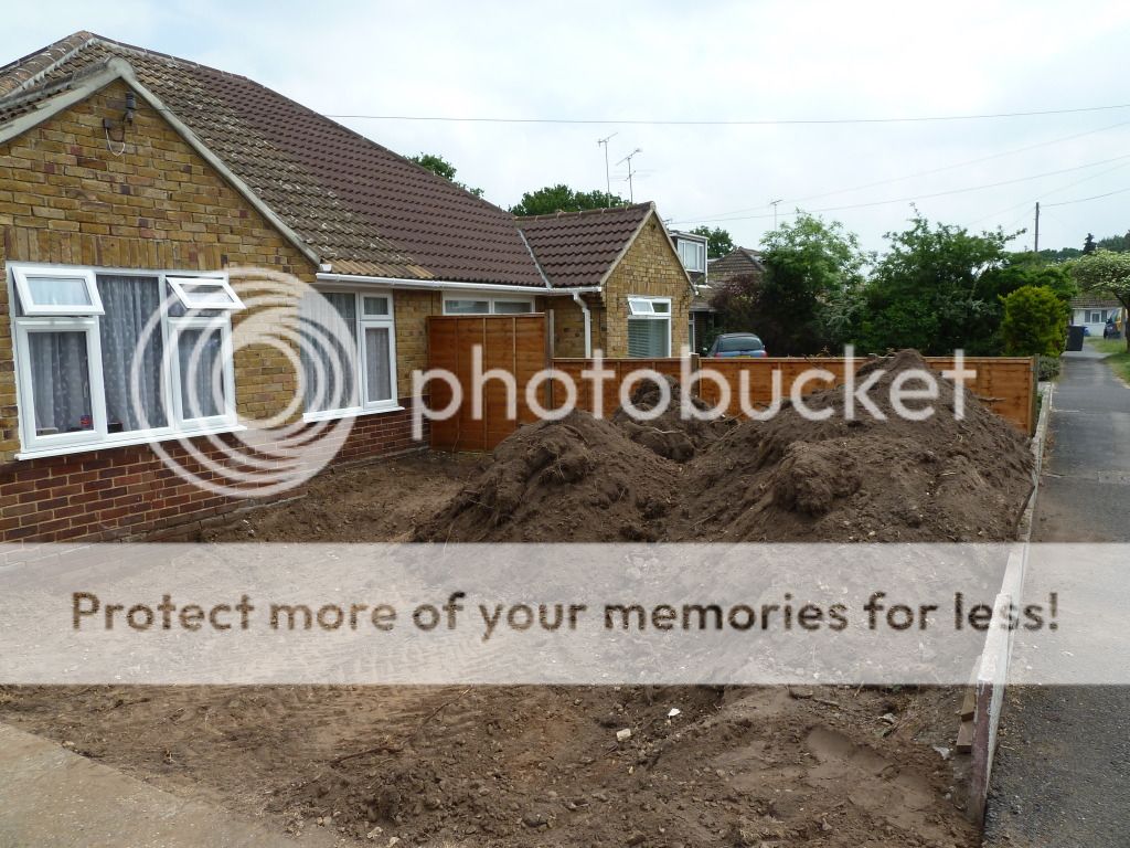

But this made a large heap of scrag ends, full of old roots and sods of turf. It also left the ground levels a bit low, so some top soil was needed. As the front will have an extra car parking space created somewhere down the line, this will need digging out for hard core first, so I removed a large section of the good soil and moved it to the rear.
I then had a space where I could resite the scrag ends to, ready for collection.
So with the scrag ends removed, there was just the question of of large pile of hard core to find a home for.
Now this had been part of my plan from the beginning, I knew I would have to build a new soakaway, and knowing that the area sits on a seam of decent gravel, I suspected that I would be able to extract enough gravel to re-use for base concreting works later. So a hole was dug , creating a soakaway hole, and extracting the gravel at the same time.
Once dug, it was simple to just fill the hole with the hard core, and level off with dirt. Final topping to come tomorrow.
So after just 2 days, some semblance of order is beginning to form.

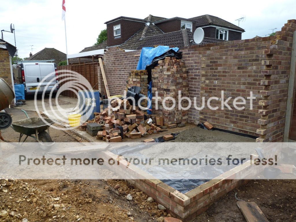

The side wall to the garage extension at the rear was built.
Which allowed for the oversite's to be concreted.
I was then able to concrete two further areas where shed's will be sited at a later date.

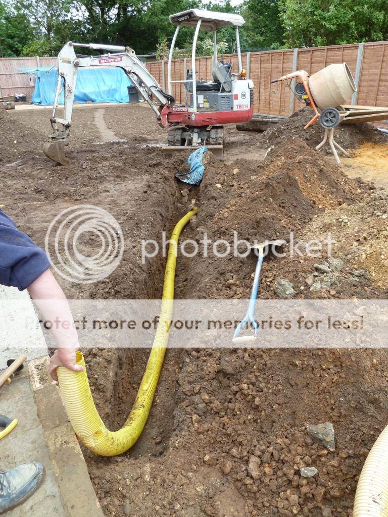

Moving towards the rear, a trench was dug and a drain for the rainwater was installed.
All of this takes time when your helpers are novices Very Happy

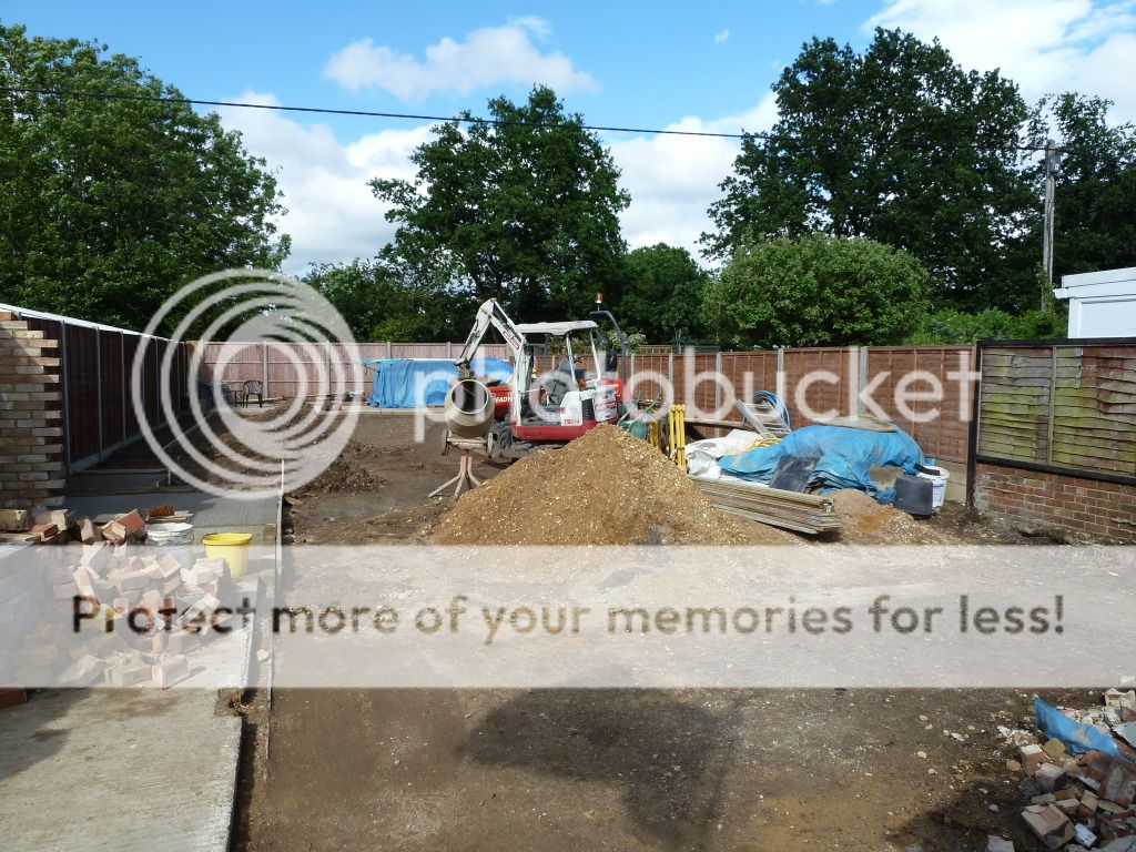

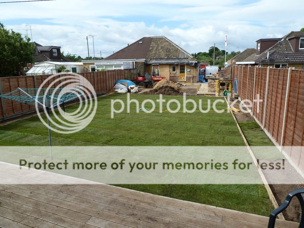

Borders were simply installed at the sides, using straight long lengths of timber decking, and final raking level of the top soil surface was commenced.
With some final moving forwards of remaining gravel and dirt, we had enough surface that I could lay the main part of the lawn, which creates a no-go area, and has the summer to establish itself.
Rear view towards the house.

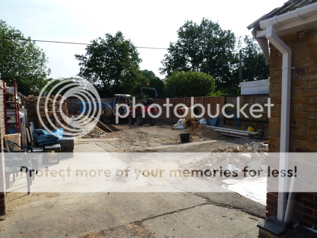

So the start of the extension can be commenced, this involves digging out completely all of the old concrete works that was the previous patio and conservatory base, - the conservatory base having been laid on top of the old patio wah
And this is where we are to date.

Gosh! laying the lawn down makes such a big difference - admire your foresight!
