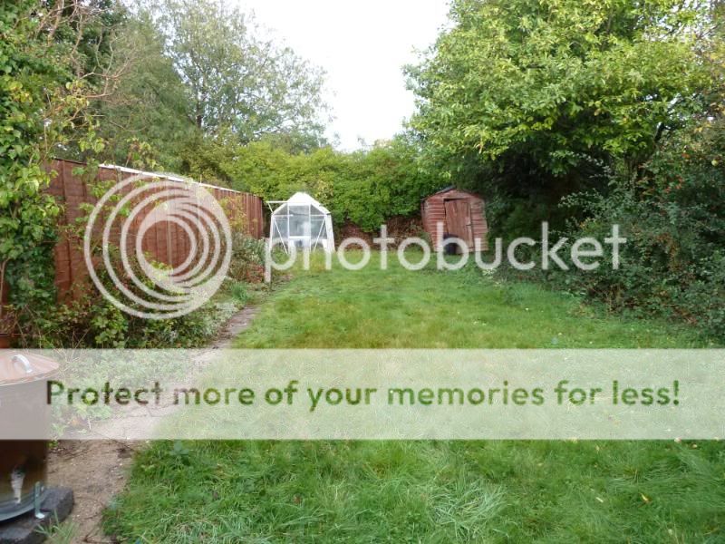

Before:

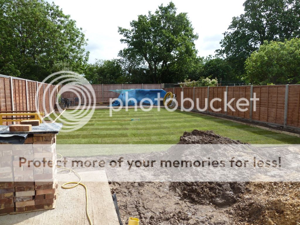

After:
Note that it's the same fence on the left, I haven't touched that.
PostSubject: Re: The Silk Purse Project   Sat Jun 09, 2012 1:14 pm
It looks MASSIVE compared to what it was . . .
Respect Shocked
PostSubject: Re: The Silk Purse Project   Sat Jun 09, 2012 2:44 pm
Love the before & after shots mate, it makes the garden look twice the size now, very impressive. clap clap Although the young slave labour is a bit OTT mate. nono Seriously, I bet they love it, as it is a great adventure for everybody. Thumsup Massive rep mate, look forward to seeing the extension through the stages. cheers

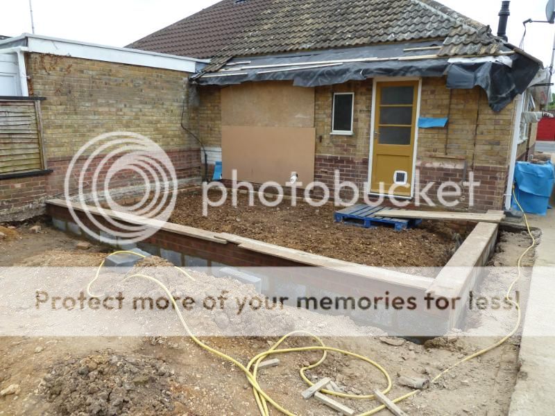

PostSubject: Re: The Silk Purse Project   Sun Jun 17, 2012 3:42 pm
Progress continues, a bit spaspodic due to the rain.
The rest of the old patio and conservatory base was removed and taken away, leaving a clear area.

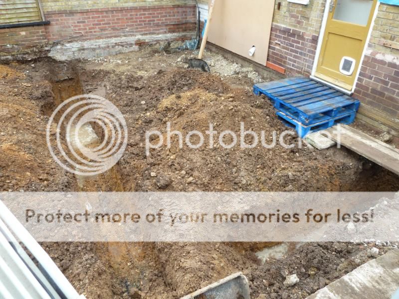

Foundation trenches were then dug.

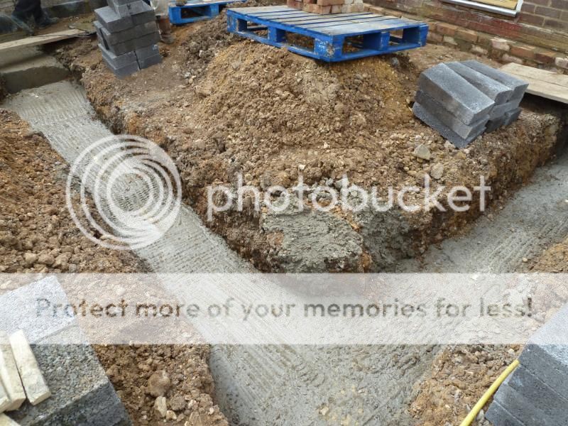

And concreted.
Footings were built.

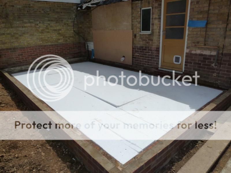

The trenches and inside were backfilled level, and then floor insulation was laid.

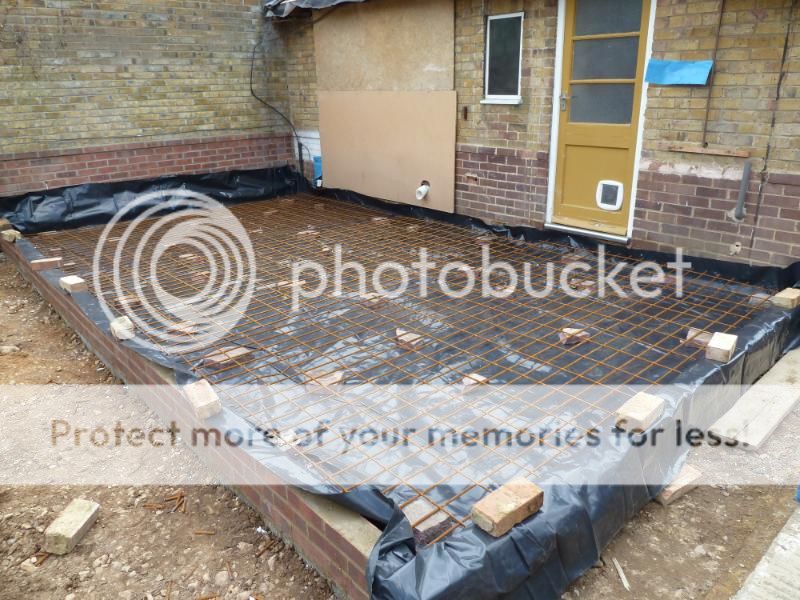

Then DPM (Damp Proof Membrane)(strong black plastic) was laid, and the steel mesh to create a suspended floor slab was installed.
And this is were we are now, ready to lay concrete for the oversite tomorrow.
What do you mean . . ? does the concrete fill in, up to and over the mesh . . . if so, why is it called a suspended floor slab?
I'm just confused, as I remember when we were laying solid wood floors, the wood wasn't laid directly on the concrete,but was 'suspended' to give some 'bounce' or 'give' in the floor.
Answers on a postcard to donttrythisathome.com Very Happy
PostSubject: Re: The Silk Purse Project   Sun Jun 17, 2012 7:29 pm
Don & I are loving following this Mark, great job you're doing. clap
PostSubject: Re: The Silk Purse Project   Sun Jun 17, 2012 8:53 pm
Yes, the concrete is placed so that there is at least 50mm of concrete below the steel mesh, and 100mm over it. The edges of the steel mesh have been cut so that they are directly above the 'sleeper' walls below. The theory being that if the ground below the slab subsides, the concrete slab won't also subside, due to the reinforcing mesh within the concrete.
