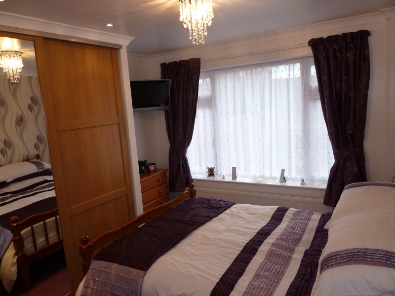

We've managed to finish off the room and move in to it, in time for Christmas!
So, the room that looked like this:
Now looks like this:
PostSubject: Re: The Silk Purse Project   Sat Dec 24, 2011 4:39 pm
what a difference ...
you wouldn't think it was the same room !
PostSubject: Re: The Silk Purse Project   Sat Dec 24, 2011 4:46 pm
Wow, looks fab. Well done to you both. :-bd:
PostSubject: Re: The Silk Purse Project   Sat Dec 24, 2011 6:08 pm
Yes really tastefully done Mark cheers

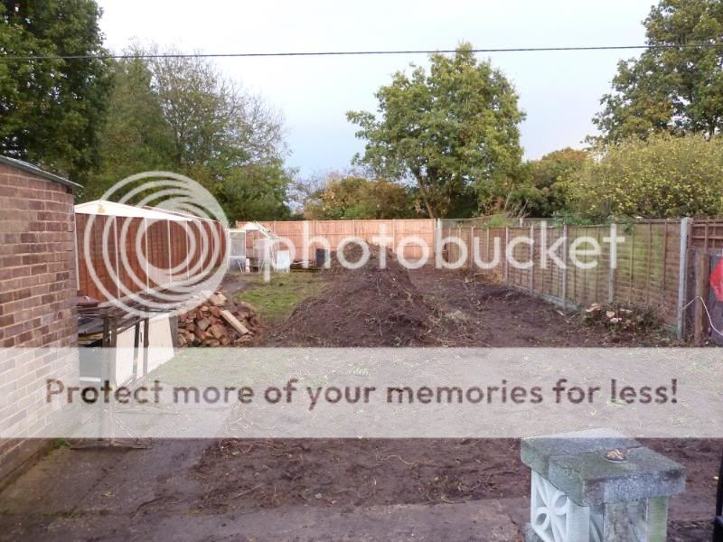

We have finished off the end wall of the lounge, and got a radiator on it (there wasn't any rads in the lounge), painted obviously, and have moved the stuff up to that end now, freeing up the far end, Jan has stripped the paper and coving down from the rest of the lounge now.
Had the architect round on Monday, unfortunately we need planning permission for the extension, it's just a little bit too big to build under the permitted development rules. So he's drawing up the plans now.
Getting some more fence panels delivered tomorrow to re-fence the right hand side next week.

The garden looks so much bigger now you've cleared it - lovely size, although I don't like those tree's at the end fear lol! I just have a fear of tree's now rolling laughing Although I know they don't affect you.

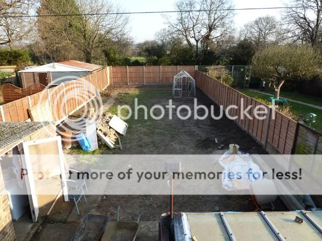

Well the fence panels came so we we fitted those, so the fencing side of things is complete now, except for a small bit that will be done once the extension is complete.
The size of the rear garden from the roof is easier to see.

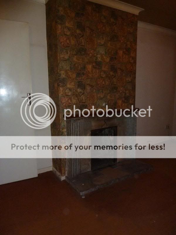

Next on the list is to take the chimney down. Jan couldn't see at first why the chimney had to come down, when it's only the fireplace in the lounge that needs removing. Of course there would be nothing to support the chimney with the firebreast removed so you have to start at the top and work downwards.
Chimney view:
Fireplace view:
So, start at the top;
And finish at the bottom;

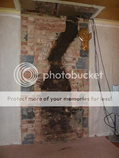

So, work has carried on, we're doing a bit all over the place now. So, from the lounge, the fireplace came down, looking like this;

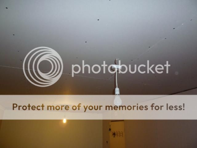

So after some final clearing off of the soot, the cables were sorted out, and I decided that it was easier to 'dry line' the whole wall, which basically means sticking plasterboard over the whole lot.

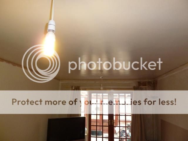

With that wall plasterboarded, the ceiling was also plasterboarded over, as the old ceiling had deteriorated too much to attempt to strip the paper off before replastering.

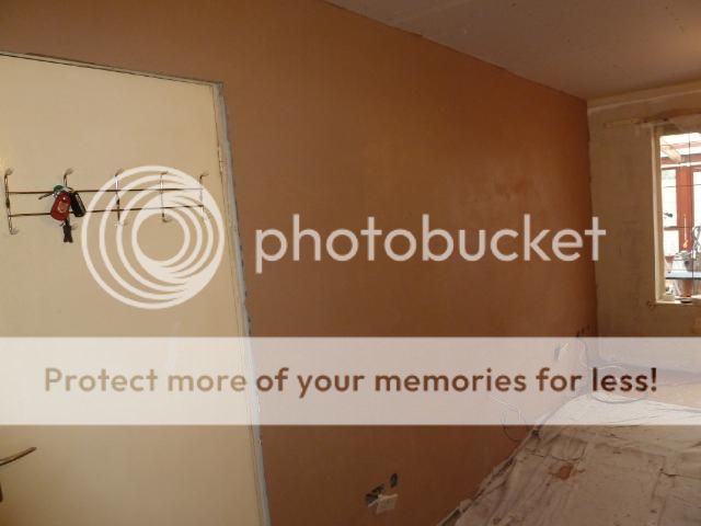

Then a simple matter of plastering over the new plasterboard.
And a lick of paint (base coat) has been applied.
So this is where we're at in the lounge at the moment. Coving and skirting to do next.

Nice one mate, wish I had dry lined my bathroom walls they were all over the place, made the job harder. Great to see it taking shape, have you just screwed straight through the plasterboard and through the ceiling into the beams

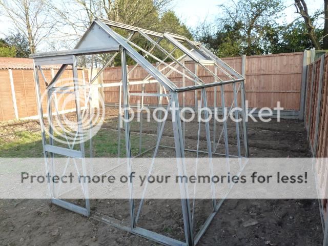

Whilst work in the lounge has been ongoing in a haphazard way, I've also made use of the dry weather since the cold snap ended.
I decided to make a deck patio at the rear of the garden, as it gets the sun all day long.
I dug 3 trenches across the width of the garden (look behind the greenhouse);
After concreting the trenches, bricks were laid where the support joists were to go, and these were fitted.
Then it's just a matter of laying the decking on top and screwing it all down. Voilá ;

...have you just screwed straight through the plasterboard and through the ceiling into the beams
Yes mate, just worked out where the joists were and used 50mm screws, through both layers of board.
